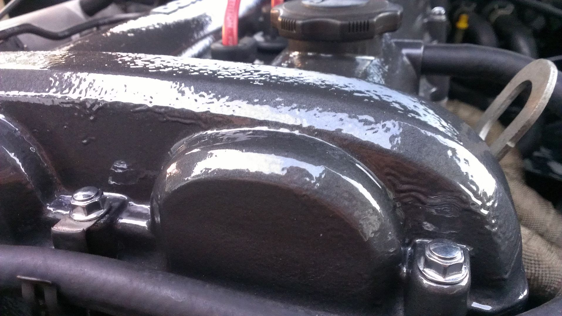

    I ask since I painted mine hammer black with Hammerite brand paint. I had a LOT of trouble with it and didn't take to the heat very well although being rated safely above engine bay heat. I read Hammerite changed their formula recently and the cans are now spotty quality. The Rustoleum cans are only rated to like 160 degrees. I want to redo My cam cover the exact same hammered color/finish but don't want to deal with the Hammerite rattle can stuff. I've seen hammered finish power coated covers and they're gorgeous but no idea who does this finish and it's probably going to be expensive.
    See here, dont use this crap. It would be gorgeous if it worked...
    This is after curing in the sun for 6 days and a couple hours in the oven as per directions. 6 months later I can still put a finger print in it or scratch some off with my fingernail. Bad can.
